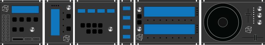

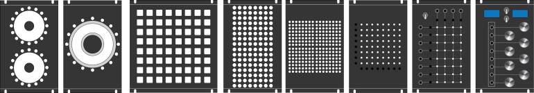

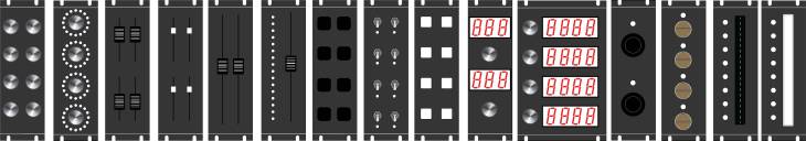

The MB-Modulbox-NG Project is a modern version of the Modulbox project .
In short words, it's a Eurorack-size compliant Modular MIDIbox Control Surface based upon MB-NG.
From a Main Part,small modules would be chained to Build the custom-sized control surface of your dreams by choosing the MIDI controls you want.
Main part would also allow Access to Menus for configuring and saving things on SD Card , and optionnal External Analog Inputs/Outputs to trigger from external sensors and/or drive your analog synth.
Each Small Module will have a Different type of Interaction and will include Digital Shift Registers and/or Multiplexers For Analog lines . Then modules would be chained one to another up to main part.
Modules Chain Connectors will be 2.54mm dual row pinheader (Molex?) and will carry Digital/Analog bus lines and Current supply. PSU Main input will be on main part PCB.
Just let a Private message on the forum to users already involved
