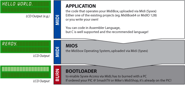

Developing Applications for MIOS
Developing custom applications for MIOS-driven Pic-Chips is very easy and straightforward:
This page covers the APPLICATION part as seen above.
