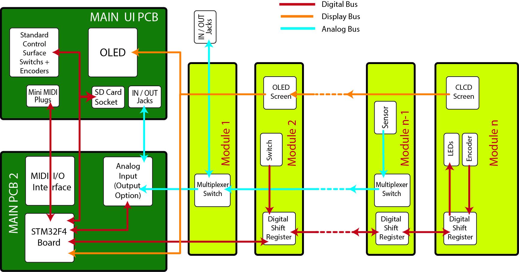

In short words, it's a Eurorack-size compliant Modular MIDIbox Control Surface based upon MB-NG.
From a Main Part,small modules would be chained to Build the custom-sized control surface of your dreams by choosing the MIDI controls you want.
Main part would also allow Access to Menus for configuring and saving things on SD Card , and optionnal External Analog Inputs/Outputs to trigger from external sensors and/or drive your analog synth.
Each Small Module will have a Different type of Interaction and will include Digital Shift Registers and/or Multiplexers For Analog lines . Then modules would be chained one to another up to main part.
Modules Chain Connectors will be 2.54mm dual row pinheader (Molex?) and will carry Digital/Analog bus lines and Current supply. PSU Main input will be on main part PCB.

Architecture
Modulbox-NG
Eurorack design

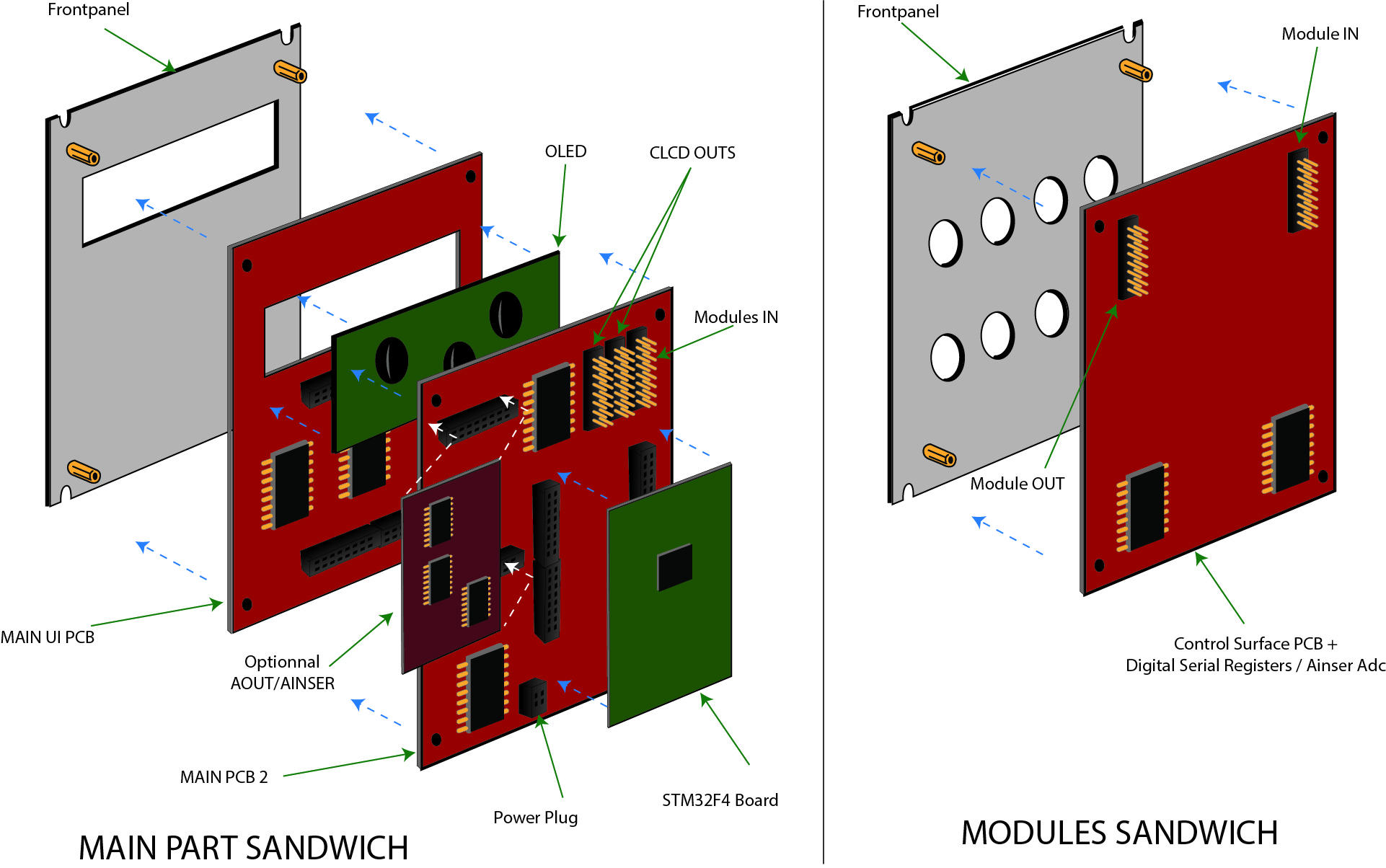

- Eurorack Design is 3U Height So frontpanel =5,25“=133mm-rails=128,5mm Height .
Sandwich Design is ok here due to non heating components and allow to spare space. - Modules Frontpanels are 8HP-multiple wide (8HP=40,3mm) see Eurorack Specification.
Frontpanel back spacers glued with JB-weld to avoid front screwing. Eurorack Templates PDF
- PCB Size is 100mm height To stay compliant to Eurocard Specification
Splitted View

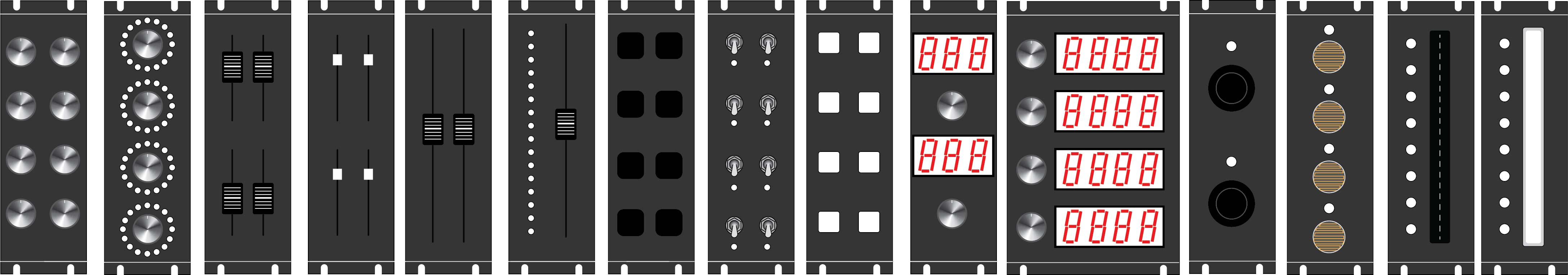

Modules List + UI Parts
| Module | N° | Analog | LED | Encoders | Switches | HP | User | Display |
| Main UI+Main PCB | 1 | Jacksx16 | x1 PushRotary | Tactilex6 | 24 | Psykhaze | Graphic-OLEDx1 | |
| Horizontal 4xOLEDS SCSE | 2 | x1 PushRotary | Tactilex7 | 24 | Small-OLEDx4 | |||
| Vertical 4xOLEDS | 3 | 16 | Small-OLEDx4 | |||||
| LCD Vertical SCS | 4 | x1 PushRotary | Tactilex(4+4+2) | 16 | CLCD 20×4 | |||
| LCD Horizontal SCSE | 5 | x2 PushRotary | Tactilex22 | 32 | Psykhaze | 2xCLCD 40×4 | ||
| Encoders x8 | 6 | x8 PushRotary | 8 | Ksir | ||||
| Pots x8 | 7 | Pots x8 | 8 | Ksir | ||||
| LED Ring Encoders x4 | 8 | 16×4 3mm | x4 PushRotary | 8 | ||||
| Faders 2×2 | 9 | Fadersx4 | 8 | |||||
| Light-Fader 2×2 | 10 | Light-Fadersx4 | 8 | |||||
| Long Faders x2 | 11 | Long Fadersx2 | 8 | Psykhaze | ||||
| Motor Fader x1 | 12 | Motor Fader | 16x3mm | 8 | Psykhaze | |||
| Switches x8 A | 13 | Tactilex8 | 8 | Ksir | ||||
| Switches x8 B | 14 | 8xBicolor | Toggle 3 polesx8 | 8 | Ksir | |||
| Light-Switches x8 A | 15 | Bicolor Opt | Light Tactilex8 | 8 | Ksir | |||
| Light-Switches x8 B | 16 | Light Togglex8 | 8 | Ksir | ||||
| Numeric Displayx2 | 17 | x2 PushRotary | 8 | 2x Numeric | ||||
| Numeric Displayx4 | 18 | x4 PushRotary | 16 | 4x Numeric | ||||
| 8×8 LED Modulation Matrix | 19 | x(8×8)3mm | Tactilex(8+8) | 16 | ||||
| 16×16 LED DotMatrix | 20 | 16 | Psykhaze | 4xDotMatrix | ||||
| 8×16 RGB DotMatrix | 21 | 16 | Psykhaze | 2xDotMatrix | ||||
| Additional Analog In or Out Interface | 22 | Jacksx8 | x8 PushRotary | Toggle 4 polesx2 | 16 | Psykhaze | Small-OLEDx2 | |
| Crosspoint Matrix 8×4(x4) | 23 | Jacksx(8+4) | x(8×4) 3mm | Toggle 4poles, Tactilex(8+4) | 16 | Psykhaze | ||
| Adafruit Silicon 3mm 8×8 Matrix | 24 | x(8×8)3mm | Adafruit Silicon (4×4)x4 | 24 | Psykhaze | |||
| Joystick | 25 | 2xJoystick | 2xRGB | 8 | ||||
| Linear Touch | 26 | 1x(Force)Linear Sensor | 8xWS2812 | 8 | Psykhaze | |||
| Circular touch | 27 | 1x(2x)Circular Sensor | 16(x2)xWS2812 | 16 | Psykhaze | |||
| Force touch | 28 | 4xForce touch | 4xRGB | 8 | ||||
| MiniDeck DJ Control | 29 | 1xScratchFader+ 1xVertical Fader | x8 3mm | x1 Code Wheel +x3 PushRotary | 32 |
