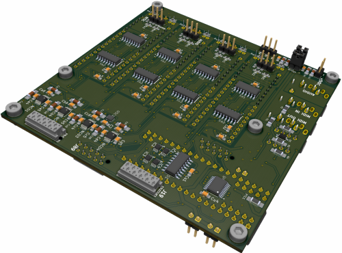

STELLAx4
4x 8Bit Soundchips/TIAś on a 10x10cm PCB,
controlled from a STM32F4 Microcontroller dipcoref4,
based on Antichambreś  TIA Module, with AD9833ś as External programmable Clock, the Frequency-range is expandet…
The Board acts a Motherboard, for
- 4x Soundchip… AND:
also like the stm32f4_module it provides:
- Midi-IO - 1x IN, 1x OUT > 3,5Jacks/TRS
 - µSD-Card - 2 Save Patches
 - J19>AoutNG - to connect VCF or VCAs…
 - J15 (JLCD1) which handle from Stock 4x SPI-Displays (SSD1306), - 4 the UI
 - J1>chain a nother STELLAx4 as “SLAVE” to it, to expand polyphony
ready for Pick and Place
–all SMD-Parts are on one SIDE and are presoldered..
