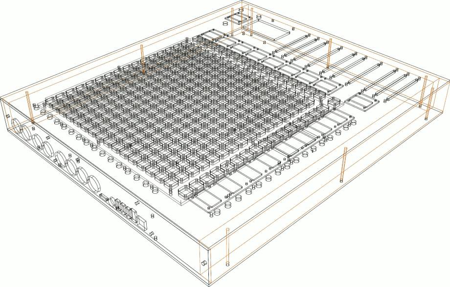

Housing and Panels
For Files and Pictures, please go to TM5-Housing

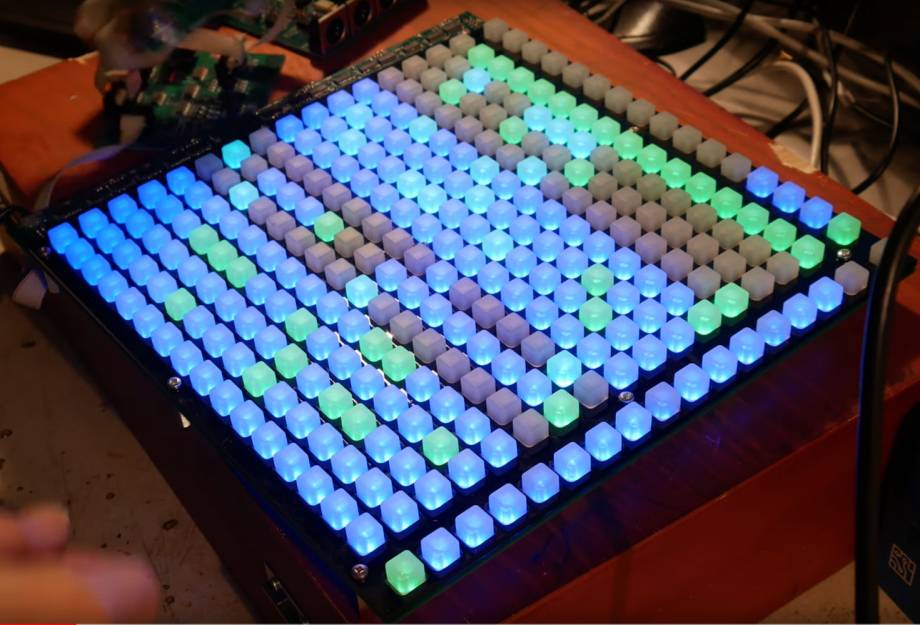

Software
You can Triggermatrix as Remote Device to controll ableton live (Launch RedBox + MidiClip Editor)
