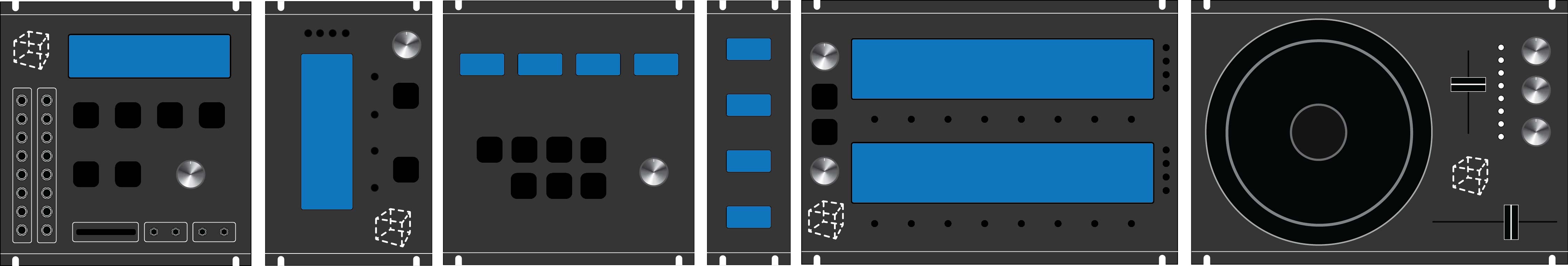

Eurorack design
- Eurorack Design is 3U Height So frontpanel =5,25“=133mm-rails=128,5mm Height .
Sandwich Design is ok here due to non heating components and allow to spare space. - Modules Frontpanels are 8HP-multiple wide (8HP=40,3mm) see Eurorack Specification.
Frontpanel back spacers glued with JB-weld to avoid front screwing. Eurorack Templates PDF
- PCB Size is 100mm height To stay compliant to Eurocard Specification
Splitted View
Tech Demos Videos
Modules List + UI Parts

Frontpanels Layouts
